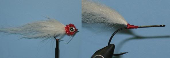

At Alan's request, here's a fly that caught my largest ever Guadalupe/smallie?/largie hybrid bass on the middle Guad (4 lbs)
here's a link to the thread, with the detailed tying instructions (and a picture of the fish)
http://www.grtu.org/forums/viewtopic.php?t=1270
the wing and tail on that fly are tied using marabou
here's a smaller version of the same fly - Little Olive Whistler. I use as a trout streamer, crappie, panfish and takes white bass when all else fails - when spawning white bass settle into stationary pods, slowly strip this fly across the river bottom and they'll pick it up when it's sitting still. Image
the wing and tail on this fly are tied using arctic fox
the nicest thing about fox fur is that it ties in so small - for the same size tail or wing, it ties in less than a quarter of the size of marabou.

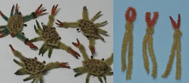

Here is a new crab fly that I came up with yesturday. I made the claws out of tan ultra chennile and the body out of furry foam. Very lightly melt the ends of the chennile with a lighter so they wont come unraveled. When coloring the claws and legs role the permanent marker along the chenille so the small fibers dont get pulled out. Any suggestions on any thing that I can do to improve it??

Alan, you'll have to give us a report on how the crab flies do. Did you add any weight to the fly?

yes theres a 1/8 oz. (mini) lead eye on the belly that I flanttened down with some pliers to give it less bulk. Hopefully by next weekend the weather will cooperate to let me go fly fishing on the flats.
