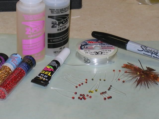

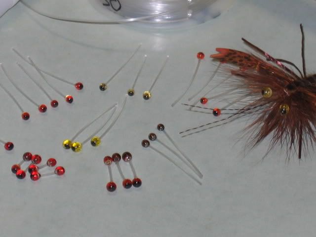

Steps to making more realistic epoxy/bead eyes.
1. Start off by cutting a piece of 30 or 25lb Hard type mono to a desired leangth
2. Place some super glue on the end of the mono and slip on a bead.
3. After glue as plenty of time to dry clip off any excess mono as close to the bead as you can.
4. Then take a permanent marker and color in the end of the bead where you cliped off the mono.
5. Coat the bead with a light coat of epoxy and place on a rotating wheel to dry.
They are quite easy to make and are very effective. They are much better than just plane burnt mono eyes. You can make them in just about any color and size. You can make single eyes or put on two beads to make a dumbbell. I often make about 50 at a time so they are ready when ever I need them, just clip them to what ever leangth desired..
The best beads I have found so far have been from HobbyLobby and are about $2.50 for about a 1000 of them. The glass beads with the metal flash in the middle (made by Bead Treasures or Czech Glass Beads) are very bright and reflect lots of light making it easy for the fish to see. There are also many diffrent sizes and colors. Best sizes are 10/0 or 11/0.

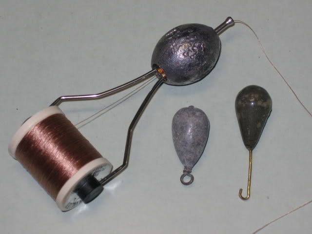

Here is an inexpensive way to make a weighted dubbing twister. Using a teardrop style weight you can bend out the metal insert to make a nice loop. Then coat the weight with epoxy to hold it in place and to keep the lead off your fingers. The weight allows you to stop in the middle of tying and always keeping tension on your thread, or when making those awkward wraps around feathers or legs, allowing you to free up both hands.
You can also get a egg style weight and drill it out so it fits over your bobbin. This way you can always keep tension on your thread when spinning deer hair.

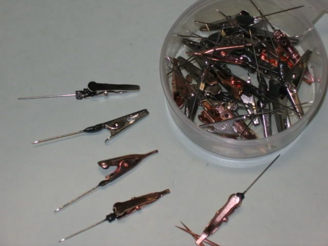

Small electrical tester clips from radio shack make cheap holding clips. They work great for holding goosebiots so you can glue them together, or what ever else needs to be held. Keeping your hands free to continue tying away! They can also be epoxied to a pin to be easly placed on a rotating drying wheel. I use these clips when making dumbbell epoxy/bead eyes so that I can put them on the wheel to dry. They sell similar items in flytying shops but are pretty expensive. I have found that radio shack sells them for 1/4 of the price and you can get them in many diffrent sizes and styles :lol:

Cool! I bought some of the alligator clips thinking I could come up with a way to do this back in the summer when I was tying clousers. I went the cheapo route with my fly turner and just bought the motor, so the stand and wheel were home made. Just sticking the hooks directly into the foam wheel left a lot to be deisred, especially with the heavy flies...after a while of rotating the hook would sometimes work loose. The clips would hopefully prevent that...
